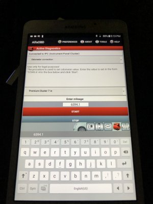

Update: Today, I switched the green and white wire from the security bypass harness and replaced the green and white wire that was factory and still am not able to proceed with alpha obd. I change the connectors back, put the tools up and went onto something else. I might have some other issues such as Bluetooth , operator error, etc. I’m doing this in my driveway using a Samsung tablet that says Bluetooth connection, but I don’t know what else to do. Any alpha gurus might know? I get to where you can type in mileage and can’t go any further. I entered my vin # in the past and does not ask for it anymore (I guess it’s storing it?) I’m trying to change my mileage on premium cluster.

I press start and nothing happens and then I lose a connection. Sometimes it then says “not connected”. I’m using a 2016 Samsung Galaxy Tab A.

It is a OBDLINK MX+, I reconnected the green and white wire from bypass harness and removed stock green and white wire harness. This is the only way to get this far; it looks like it will almost do it. When I turn off ignition switch and turn back on, wait for startups, I then click ok and then that’s when it says it cannot connect. It kicks off Samsung Bluetooth and button grays out. Maybe I need to reset the alphaobd app and start over, I could have clicked on something wrong when I first attempted this.
