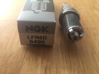

A performance engine builder friend showed me a spark plug code diagram for finding or building custom spark plugs
NGK has some charts online and I found some multi electrode plugs that are not rare metals tipped.
LFRD 6490

The befits of multi electrode plugs are gap retention, added proportional ratio indexing and redundancy in the event of increased detonation pressures
other than those positive aspects they are the same plug as factory specifications

These NGK 6490’s are colder plugs than stock and will not benefit everyday driving unless you have a tendency to put your foot into it
Because they are a cooler rated plug they may be more susceptible to carbon fouling when used for moderate driving practices
Specifications for both NGK 6490 and NGK 92174 from Sparkplugs.com
NGK LFR6D 6490
multi ground electrode spark plug
  • Thread Size: 14mm
  • Thread Pitch: 1.25mm
  • Seat Type: Gasket
  • Resistor Value: 5K Ohm
  • Reach: 26.5mm (1.04")
  • Hex Size: 5/8" (16mm)
  • Terminal Type: Solid
  • Overall Height: ISO
  • Gap: .024" (0.6mm)
Center Electrode
  • Material: Nickel
  • Type: Standard
  • Size: 2.5mm
  • Projection: Projected
Ground Electrode
  • Material: Nickel
  • Type: Multi-Ground
  • Quantity: 3
Specifications
  • Warranty: 1 Year
  • Torque Specs: Cast Iron: 18-25.3 lb. ft. Aluminum: 18-21.6 lb. ft.
  • Brand: NGK
  • Heat Range: 6
NGK 92174 LZFR5C-11
single ground electrode spark plug
  • Thread Size: 14mm
  • Seat Type: Gasket
  • Overall Height: Bantam
  • Gap: .043" (1.1mm)
Center Electrode
  • Material: Nickel
  • Type: Standard
  • Size: 2.5mm
  • Projection: Extended Projection
Ground Electrode
  • Material: Nickel
  • Type: Standard
  • Quantity: 1
Specifications
  • Warranty: 1 Year
  • Brand: NGK
  • Heat Range: 5

So nickel electrode, Check gaps(narrow feeler gage) at 30k and replace by 60k miles... Little colder will lose a bit of N/A power. Power adder engines will benefit from the lower igniting temps.
2009 revisions on 5.7‘s redesigned the piston head compression ratio to 10.5:1
up from previous 9.6:1
A cooler plug attracts and removes some of the excess heat transfer from the 09’ revised 65cc oval chambers
Multi ground electrode plugs do not require gap adjustment since they do not reach over the top of the center electrode
The problem most people find is fouling from carbon deposits if the engine is not driven over 50 miles per trip and or uses a colder radiator coolant thermostat
