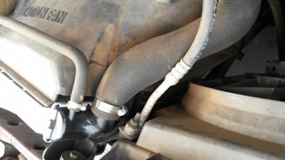

Hi everyone. This is my first post here! I have a 2003 4.7L Ram 1500 SLT with 145,000 miles. My mechanic replaced the radiator about two years ago and I've recently noticed coolant around the base of the radiator cap on the reservoir. I replaced the cap and the coolant, albeit much less than before, is still appearing on the reservoir right below the cap. Additionally, there is a white film that looks like dried liquid on top of the cap. Could the leak be from the collar the cap screws into? I've attached pictures. On another issue, I don't think the mechanic changed the hoses when he changed the radiator. The hose from the radiator to the engine looks like a snake ate a rodent. It kinda looks like it's going to burst. Check out the attached pictures

Definitely change that hose right away. Then I would rent a pressure tester and see where the leak is coming from.

Thanks for the advice. I'll change the hoses then rent a pressure tester to see where the leak is. I'll even buy an original MOPAR radiator cap if need be.
