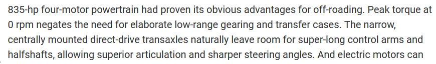

Somewhere, I think your units are way off and you are not comparing apples and apples.
For example, in the Rivian the front two motors (together) produce 413 ft-lbs of torque and the rears (together) add another 495 ft-lbs. TOTAL torque is 908 ft-lbs or about 1230 Nm (not 12,000 Nm). In contrast, the 5.7 Hemi has around 410 ft-lbs.
Torque delivery is much different insofar that the electric engines can have 100% of their max available instantaneously.
In your "grunt pulling" scenarios, the electric motors have the potential to be "much better" than an ICE engine getting torque to the ground sooner at slower speeds, but in practice both the EV as well as the ICE will be limited by tire traction. (In theory, the EV may once again have a small edge because of the added weight.)
This motor trend article says Rivian has "direct drive transaxles" - https://www.motortrend.com/features...e-review-trans-america-trail-off-road-part-2/
If the transaxles are "Direct Drive" then that means wheel torque is motor torque. By comparison a ford pinto can deliver 1273 ft-lbs to the wheels in 1st gear. If the Rivian axles are "Direct Drive" to the motors, and the motors make 908 ft-lbs torque then a Ford Pinto would demolish a Rivian in a drag race, at least up to 20mph
We know that isn't true.
In this interview with Richard Farquhar (Rivian VP of propulsion) https://chargedevs.com/features/qa-with-rivians-vp-of-propulsion-full-interview/
he says "Each drive unit assembly has two electric motors – four total – independently connected to the driven wheel with a fixed-ratio single-speed gearbox"
and then later in the same interview he says "We achieve over 14,000 Newton-meters of grounded torque at the wheels combined"
That sounds completely reasonable and he would know since that's his whole job. Cool. But that still means a Kia Sportage can factually deliver more torque to its rear wheels than a Rivian R1T, period. Apples to apples.
I'm certain that's fine for a Rivian because let's be real that truck isn't being marketed to rural folks. I am curious about the RamCharger because Ram clearly wants to address range anxiety and charging and I like it so far, but no matter what they say 10k ft-lbs divided among four wheels (and never more than ~50% to the rear) is not at all the same thing as 20k ft-lbs to the back wheels which is what a hemi ram has right now. Whatever the front wheels can supply is basically meaningless from a dig because they're not going to benefit from any weight transfer. On a longitudinal drivetrain with a locked center coupling the rear axle can get 100% of the total torque.
I do not care one bit about 0-60 times I care about getting work done.
I know eveyone is just a name on the internet. I grew up on a working farm and been an outdoorsman my whole life. It doesn't make me special but I think it's fair to say I have a real good handle on the topic of pulling stationary and reluctant objects with a chain and a pickup truck on every kind of surface. Anybody who's lived that life has. That's where I'm coming from. If Ram wants to sell these trucks to people like me I'm all ears; convince me. I don't care if it's powered by gas, electrons, mashed potatoes.. will it get the job done and keep money in my pocket?
