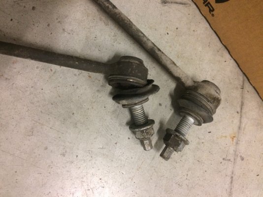

I had rattle noise too. Check your rear sway bar links. That is most likely is the problem.

I forgot to mention the bushings also. They are cheap. If you were to replace the sway bar links,replace the bushings also

I'm gunna try the brake calipers. It sounds more like it "could" be around the wheels to me cause it is louder when I brake and turn. It wasn't the sway bars, checked them and they are good and tight. I've removed the clamp from the y-pipe already a few months ago and that wasn't the issue.
