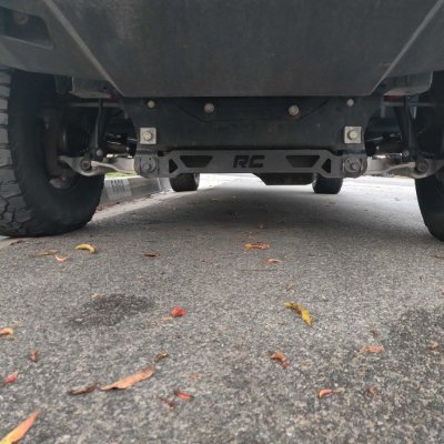

Here's pics of how it sits. Like I said I'm happy with ride height....just not the uptravel, ground clearance and CV angles

Does anyone have a photo of their Eco with a 4" suspension and the control arm angle?
I'm wanting more uptravel in my suspension.
Also I feel I probably need to replace my strut/coilovers assembly up front due to wear and tear and time. Been almost three years of hunting/off road use.
Will running Bilstein 5100 help with leveling my control arms for more uptravel?
What are my options on going more clearance in front? Is this just a spring sag issue?ab1e17e4b3c106576035bad259b5d242.jpgf1f2439909722adf4de52b3554dc0476.jpg
Sent from my ONEPLUS A6013 using Tapatalk
I'm seeing some abnormal tire wear in the first pic. So I'm led to believe that there's more than struts and spring issues happening. I'd be interested in seeing more pics of the truck not just underneath it. Also pics from the backside of the tires towards the struts...
