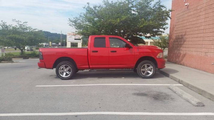

I have 1.5" TGC rear coil spacers (steel ) and still on my factory shocks in the back , no issues at all .
I have bils up front @ + 2.8" . Love the ride of the bills !
I've had my steel spacers installed for a while now and have had no issues at all , no metal to metal sounds or anything .
I was originally gonna get the poly spacers , but a member here had the steel ones for sale for cheep .
Here's a link to my rear spacer install .
http://www.ramforum.com/showthread.php?p=1418741
And here's a link to my bilsteins 5100s install in case your going that route . Hope this helps !
http://www.ramforum.com/showthread.php?p=1206420
