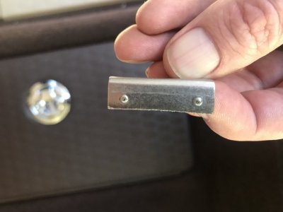

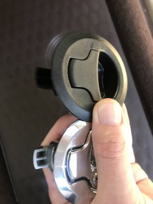

There are two key differences that are not accounted for in the dimensions provided. The first is the length of the latch itself. The one I linked in the original post (Amazon) has about a 3/8" reach on the latch and the OEM is about 1/2".
The other is the length of the catch. More on that later.
So you need to use the opposing catch that is provided (Below).

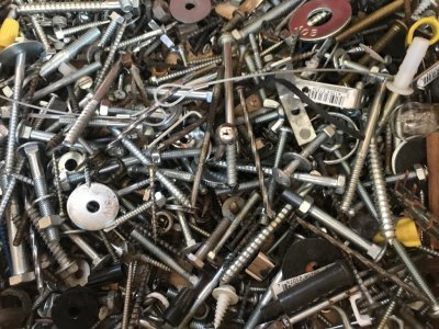

Throw away the lock's mounting screws (left), they are too short
You should be able to find the correct ones (right, above) here (below). I hope we all have a drawer like this one. Saves a trip to the hardware store.

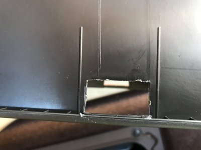

The first is to trim the bucket insert - your beer cooler Bigred. You don't have to take much off, you are really just squaring up the hole so the catch will fit through.
Then you need to grind down the length of the catch. Not much, go slow you can't put metal back on. If you have to mount and grind some more do that rather than go too far.

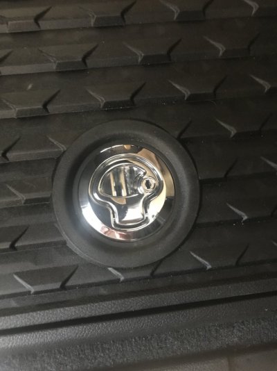

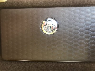

Put Bigred's beer cooler back in, mount the lock to the door and you're done.
The whole thing took about 40 mins from start to finish, including digging in the drawer for the screws I needed.
