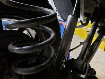

I have Bilsteins up front, and just put a set of Pro Comp Pro Runner Monotube Gas shocks in the rear ... I like the ride a lot ... You can get em at 4wp for $56.38 ea ... pn zx2028

You have the 5100's up front already so why not match the rear shocks with Bilstein 5100's ? part# 24-187374

I had bilsteins on both ends on my 2014 and the rear 5100s are standing in the garage for about 2 years with about a thousand miles on them . They were to stiff for a normally empty short bed reg cab . I would try Fox. I replaced the Bilstein with a Rancho 5000X which many people with Jeeps were really impressed with as was I for a cheap shock so I figured it was worth a shot. They were no different than the Bilsteins. I tried Fox 2.0 on a Tacoma I was playing with and really liked them on that truck .

We recommend the Fox rear shocks. They will ride better than the bills and are good for up to 2" of lift. Message me for a quote if interested.

I have a set of longer B6 4600s that might be up your alley. I need to grab the part number, they’re 1.5” longer than the 24-187510 I’m using.
Want to say it ends in 375 or 350.

I know Bilstein has a pretty good following on this forum but I know on another its common to read with Bilsteins you can not only feel a dime when you run over it but you can tell if its heads or tails. I don't care for them on our IFS trucks or Jeeps and I have tried Twice on Rams and no more . Compared to Fox they are cheaper which may be one reason ya see them so much but when I eventually gave in to Fox I understood why they cost more and they are worth it .
