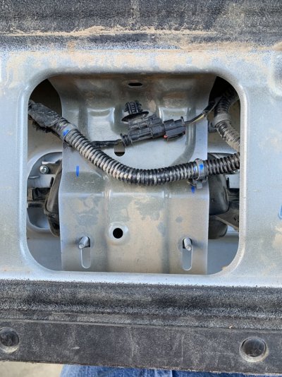

I’m installing a new Expedition One rear bumper in my 2019 Power Wagon but can’t figure out how to remove the tailgate backup camera so that I can reroute to the new bumper. The swing out arms with Geri cans and spare tire will block tailgate camera.
GTyankee
Nov 2, 2020
12,391
17,459
El Cajon Calif. 92021
3.0 ecodiesel
The new fancy Rams have a Video plug in the rear bumper, it is on the opposite side from the trailer plug.
The Video plug looks like a cable tv hook up
you can run a hard line to a camper in the trucks bed. or to the rear of a trailer or inside of a trailer
