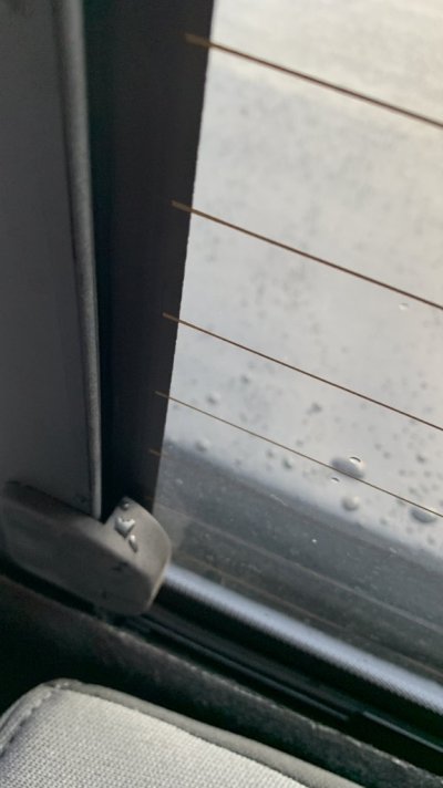

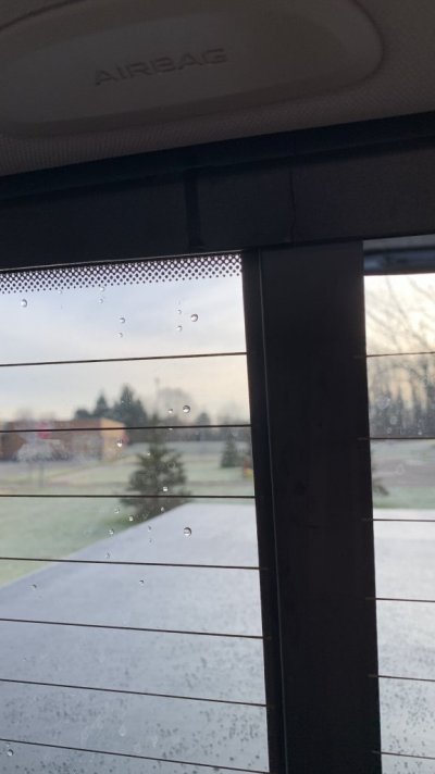

Same issue here on my 2019 1500. I just purchased Certified Used from local Chrysler dealer Nov 19 2021. So I’ve owned it less than a month before bringing it to the dealer. Saw drips coming down from rear window while driving then I noticed the cracks see attached. I also purchased the dealer’s highest level of extended warranty. The dealer’s pamphlet for the insurance says “It’s so comprehensive that’s it’s easier to tell you what’s not covered” window assembly’s or manufacturing defects are not listed on what’s not covered. Dealer is now saying they would not cover the replacement and advised me to call RAM Care. Ramcare told me that since I was not the original owner they would not have any lenience on this. Now I’m stuck with the bill… I’m a first time RAM owner but this will probably be the last ram I ever buy after this experience.
