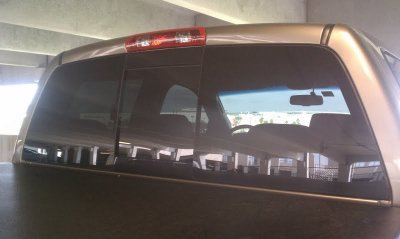

Got the rear window replaced with a solid one. Only thing that sucked is I had to take if back to my tint guy to get it re-tinted since they only had the non-tinted factory one in stock.
here's before and after
