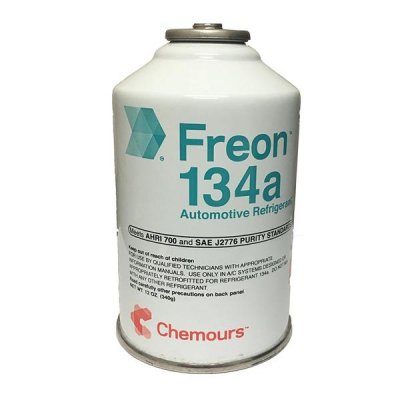

First of all it's not freon, freon was banned years ago. It's refrigerant.
"Freon" is actually a trade name much like "Xerox" is refered to as photocopy and not specific to any one banned refrigerant.
There is a "Freon 134a" which is a Hydrofluorocarbons (HFC) refrigerant made by The Chemours Company which is a spin off from DuPont who originally developed the refrigerant with General Motors. DuPont originally sold 134a under the name of Suva
The 1234YF refrigerant is a Hydrofluoroolefins (HFO) categorized as having zero ozone depletion potential (ODP) and low global warming potential (GWP). The banned refrigerants are Chloroflurocarbons (CFC) and Hydrochloroflurocarbons. (HCFC). Eventually even HFCs will start to be phased out unless you live in California because they're starting to cram that down your throats now.
You are litterly the only person I have ever heard call it freon 134a. Every HVAC tech (residential, industrial, age automotive) I know or have ever met, refer to it as refrigerant, be it freon, r12, r134a, or 1234yf.
you missed the quotation marks, I was referring to the actual name on the cylinder and referenced the "Suva" name when it was sold by DuPont.
The brand/trade name of "Freon" was synonymous with CFC and HCFC refrigerants, 134a was probably the only HFC in the bunch.
I've probably used at least 5 different brand names of more refrigerants than most HVAC service techs have ever come across in the field.
