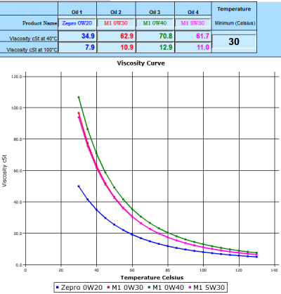

Eventhough redline is a very thick 0w40, surprising most of it shears in use. If you look at all of these examples, your 5w30 will likely be thicker then any of them in this uoa. The amount of vii's in these oils have them sheared down well below what redline starts at. If you look at hammers 3 reports on PUP 5w30 redline is plenty thicker then that through out the interval. I would however look at page 93 in the oil filter thread to consider other filters. My redline 5w30 uoa's are all about these numbers, even 2 years 10k miles. Look visc at 100. If you want to think about winter rated and flow, look at 40c on stat sheet. 5w30 will flow plenty better then 0w40 when it is cold.

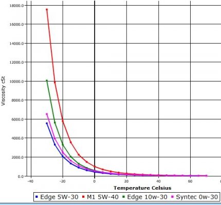

Using your example I will post those two oils viscosity when colder then operating temps, 100f. Now, the colder you get, the range will even grow larger, I will post a cold flow graph just fyi. All zero winter rating means is it flows best for THAT weight, not against other weights. Just copy and paste, as you see 5w30 flows best at 40c, now note the cold flow chart, the number becomes astronomical in the cold.
Redline 5w30
Vis @ 40°C, CSt71
Redline 0w40
Vis @ 40°C, CSt86
Redline 5w30
Vis @ 40°C, CSt97
There is more detail in syn thread, more involved then I wanted to be. Glad it is working for OP, the science is that 5w30 redline is gonna flow well in cold, be stable throfguhout the interval, and be thicker then 0w40's at the end of an interval. Use whatever oil you wish, it is a solid choice for those who want to do it as 6.4 owners hemiman and kyle will tell you.
