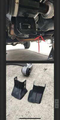

2019 lift this is what is cut off for a lift on independent front suspension (1500)
The pieces in the bottom pic are cut from where the arrow is on the top pic.
Uugh, ok, so that answers that question. Thank you so much for taking the time to help me.

If you can get me a picture of the crossbar straight on I can tell you for sure if it has been cut.

Ok, let me see if I can get better pics. I think i know what you are looking at.
