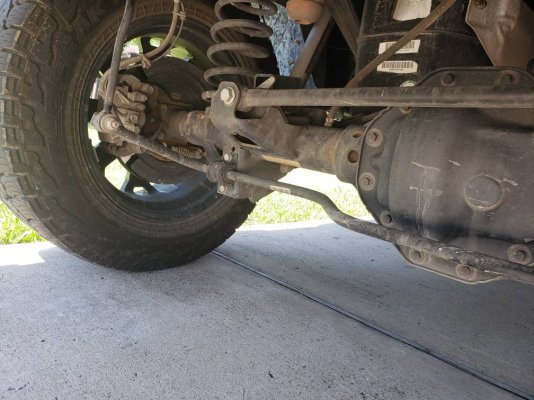

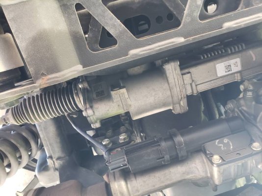

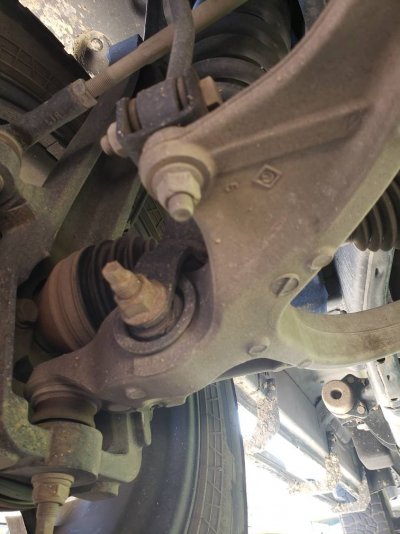

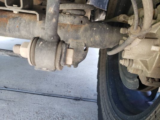

Ok, please keep in mind I have no idea what I just took pics of. I really didn't have any reference, so if it's not what you need I'll do my best to pinpoint what it is you are looking for. 3347f4e965a4c6aadc73cf7dc306efec.jpg35cd0f4b93f30a2008b2b3118dba8726.jpgae083db62fb6abea3f225857591b098f.jpg1523054e9e3992a9ece4ee88de9db232.jpgf19bfc804558925de4d95910b9c4b104.jpg47ada6fea1d143f617d116c898d8cba3.jpg054f0dab184a4ceaee18a9d207f3d95d.jpgd8ee18dff412f99056f4ea6142fbf7e5.jpg
your frame has been cut for the new crossmember so there is little chance to go back. See attached pic. I’ll also see if I can share a pic of a 2019 that I lifted for a buddy so it makes more sense for you.
