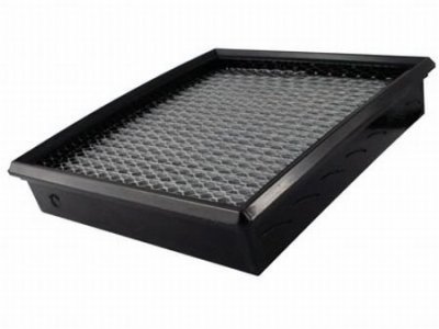

What is everyones thoughts on replacing the original air filter with a drop in filter?
Im looking at AFE and am especially intrigued by the inverted filter that fits in the rectangular opening but then acts like a cone filter with more surface area?
Also have read a few places about removing charcoal filter, thoughts?
https://www.autoanything.com/air-filters/61A4151A0A0.aspx

No I never got it, I don't like being the test dummy. I think it would probably be the best option though don't you? The inverted come style

I would think so. More surface area. It’s got to be tough being designed to have a turbo pull air through it at 50 psi plus. I understand not wanting to be the test pilot. But I kinda want one too.
