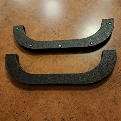

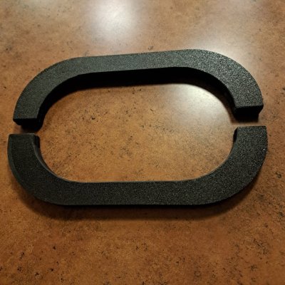

I received the trim pieces today. I will post some pictures after I install them.

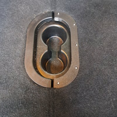

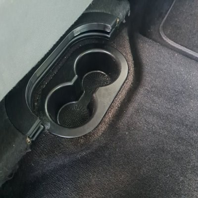

I installed one side, but a storm kept me from doing the other. I had to ream out one of the holes in the floor, to get the two halfs to fit. No big deal, as the floor is made of fiberglass. I will try to get the other one done tomorrow.

Sorry , it took so long to get back. I was planning on replacing the second set that Patrick sent me, but I have been unable to figure out how to get the undamaged factory ones off. I don't want to damage the unbroken ones , so I think I'll leave them there for now. If anyone knows an easy way to get the factory ones off without breaking them , please let me know.

If you are replacing the breaking prone OEM ones, why would you want to save it?
The OEM one still remaining can be popped off with a screw driver but will be ready for the trash can when done.. That's how I did mine. I also screwed on from the back so the screw heads don't show. Took all of 15 minutes start to finish.

Hi indyNick glad they worked out.
Just like " 04fxdwgi" said. Use a screwdriver and pop right off. If you look at the oem trim they are held together with a snap.. ( kinda reminds me of a zip-tie) my trim are a little bit beefier than the oem and also. I did want to note. When you install my style the screws should be facing down when the floor is UNFOLDED flat. If you look at each piece I sent they are marked " top & bottom"
I did it this way to try and keep the oem look as close as possible. Did you receive the mystery gifts?

Yes I did. Thanks. My granddaughter loved the Ram wheels, and my wife though the screw driver was cute.
I finally found the unbroken factory half, and I see the tabs you are talking about. I will get that a try.
I installed your parts with the screws facing up, when unfolded. I did not want to see them, when the floor was folded.

that makes great since, the way you done yours is how i will tell others. I never thought about when the floor is in the folded position you will see the screws.

The parts Patrick sent me are functioning perfectly. And they look great.
