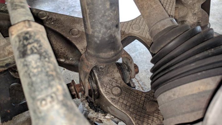

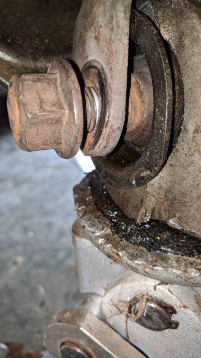

These stupid @$-_+@)&!# bottom bolts. They are completely rusted and seized inside the sleeves thru the bushings. Dealership does not sell the bushing to the general public!
What a pain in the rear. Just wanted to vent. Looks like I'll need to air chisel them out. Any advice?

Yes they a ********. You can buy a kit though so once those are destroyed you are good. Here are the two I have used.
Moog K200688 Control Arm Bushing https://www.amazon.com/dp/B00CE3OVME/ref=cm_sw_r_cp_api_z9UqAbY93JK4P
KYB SM5743 - Mount Kit https://www.amazon.com/dp/B0142SM4UO/ref=cm_sw_r_cp_api_P-UqAbVQB6751
I have not tried this one but it would work too.
Monroe 908962 Strut-Mate Suspension Control Arm Bushing Kit https://www.amazon.com/dp/B00DOP13V8/ref=cm_sw_r_cp_api_y.UqAbVTE5BPY
With the Moog one I listed you will need the bolt and nut from the dealer for both sides. I ended up torching them off and the nuts from the bilsteins I had on for over 100k miles I had to torch off too. If they used a fork like they do for the rear it would have been fine those won’t seize on.

Thanks. I'll see if stealership will let me get them if not, I'll Amazon them as I should have lift access Thursday

Used a ball joint press and it didn't move. Looks like it's a cut and press out type deal. Gave up and ordered the gromet kits.
