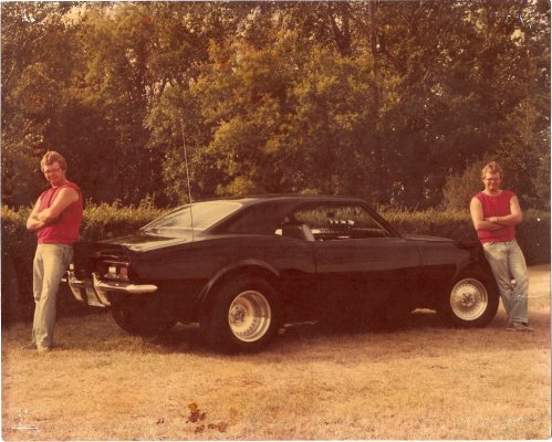

My truck would spin the drag radials a good 1/2" after a night at the track. I used to screw the slicks to the rims on this old toy,otherwise i'd tear the tubes,lol
