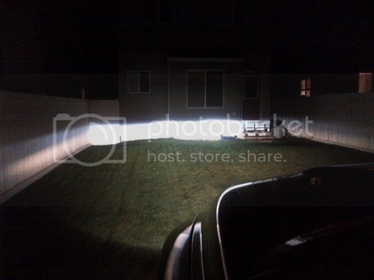

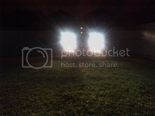

But the blue! :( hah. Too bad he doesn't go above 6000k and maybe mix/match the bulbs. I think I'll be able to deal with the minor differential.
Keep in mind, the camera will distort photo color too,
My 35w/5000's HID's look pure white in person, slight blue near the cutoff due to prism effect
Photos look way too blue sometimes, specially when I turn my stock halogen fogs on
the light from my halogens fogs looks white (but only on their own)
the light from my 35w/5000 projectors looks white too
But put them on together and its quite obvious I need a Fog HID upgrade now
Bottom line, don't judge color choice by internet photos'
IMHO 6000k is max and Blue is the color of Rice :puke:

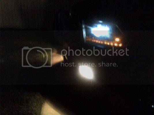

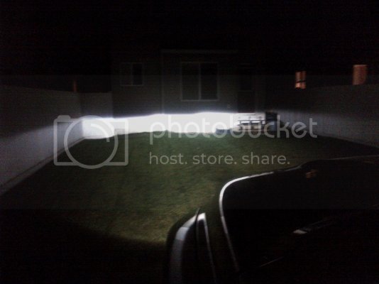

Actually 4300 is considered day light, 5000 is just a hint of blue
And here's the blue tint I was referring to near the cut-off line on a 5000k
I think I read somewhere that 5000k has the best output (lumens) all else being equal.
and I think that's what Jeremy uses himself and recommends to most of his customers.

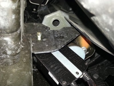

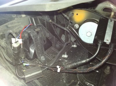

Would you be able to post a pic of the way u set up the wiring for the fog lights? I just ordered mine and want to see how u did it. Thanks.
I originally had a theory that liquid would cause issues with them mounted here, luckily I was able to put that theory to test a couple days later. We had major storms roll through and caused minor street flooding near my house. I drove the truck through the flooded areas and had water splashing everywhere, and the HIDs didn't even twitch, so I guess it's all good.
0212353
Vendor
Jun 29, 2010
26,460
2,029
Florissant, MO
2x 5.7L & 6.2L
all potted for waterproofing!
Hell........dunk it in water.....all good. ;)
BlownGP
Feb 10, 2013
6,142
1,696
Houston/Baton Rouge
Yeah those connections seal pretty good with the gaskets on them. The ballast for my fogs sit right above them and have been soaked with water a few times. No problems. We got that same storm last week and I had to drive through some high water on my way home.
