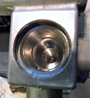

This pic might help a bit to ,you can see how the flow path is inside the thermostat housing.
I see the hole in the bottom bore at Approx. nine O-clock which goes to the heater I believe.
I see a hole just inside the upper bore at Approx. six O-clock. I believe that this is the entry point for fluid returning from the cooler. I can just barely sense a hole near the bottom of the upper bore at Apron. three O-clock. This hole I believe would lead cooled fluid to the transmission. Is this all correct?
caulk04
Supporting Vendor
Mar 24, 2013
1,099
2,428
Looking into the bore in that most recent picture:
Hole at the bottom is fluid coming into the cavity from the heater.
Hole nearest the top is fluid entering the cavity from the cooler.
The hole you can't see clearly at 3oclock is where the fluid reenters the transmission.
The stock thermostat travels down into this bore to gradually close off the lower and open the upper path as the fluid heats up. My part mimicks the thermostat in it's open position which blocks the return from the heater and opens the return from the cooler.

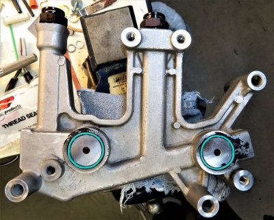

In this pic,the middle hole at 3:00 is hot pressure side fluid from transmission,bottom hole at 9:00 is hot pressure side fluid fed to heat exchanger,the upper hole at 6:00 is the hot pressure side fluid feed to the cooler in the top of the A/C condensor.Thermostat is always installed on the hot side of the liquid/fluid you're trying to regulate,never on the cold side.Everything in this photo is on the out pressure side feed from the trannies internal pump,and is in the hot side of the fluid,which is what feeds to the exchanger to either have the heat in the fluid increased by the coolant,or is fed to the cooler to have the heat in the fluid decreased,nothing in this photo is a return,it's all a pressurized "out" feed on this side
Left side is thermostat side

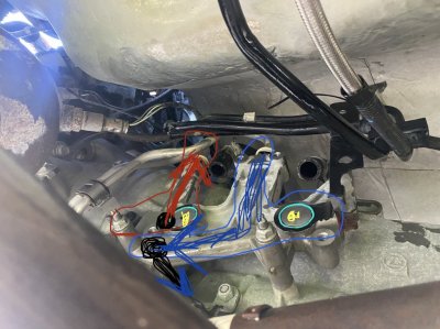

In this picture, port A is fluid into the trans, port B is fluid leaving the trans.
Red arrows are fluid leaving the trans, going towards the cooler and heat exchanger.
Blue arrow is fluid coming back from the cooler.
Multi color are the ports between the heat exchanger and manifold.
Because it's such a short path, fluid will flow through the heat exchanger much more easily than it will through all the lines to the front of the truck unless forced to do so by an open (hot) thermostat or my valve.
Fluid flows into the thermostat housing from either end, toward the middle of it where it reenters the trans.
This pic is back asswards,the thermostat is never installed after the cooler Jesse.The red arrows in this pic are the cool side return from the cooler,where the blue arrows are,is the pressurized hot side from the tranny to the cooler.The blue arrows are actually on the pump side and should be red and facing the other way.I should of paid more attention to the photo earlier,that's what you get for just glancing over things,lol.

I totally agree that that makes more sense, but I'm basing my info on that nice computer model that wouldn't have been created by some schmo without a clue. Could entirely be wrong, but that's my thinking.
It doesn't matter which direction the fluid flow is for my part, the bottom port is for the heater and is blocked.
Took me a minute to find the pic you're talking about,but it's wrong to,lol.Not the first time i've seen diagrams like that done wrong by a "schmo" that was probably handed a rude and crude hand drawn facsmile to create a nice computor rendering,lol
Very good chance who-ever did the putor rendering had no idea what they were drawing,and where the lines go out of sight on the other side of the bellhousing,they got the lines switched up by mistake,as there's a bit where the cooler lines disappear in the drawing.

So... Doing more reading and thinking, I came across info that conflicts with what I was told here about flow direction between the trans and thermal unit. Seems it flows out the lower port on the trans which would pressurize the deepest port of the thermostat housing first. This reinforces my idea in that there is a bypass for the fluid should the heater and cooler become blocked. The plug I've made retains this function.
Note on this model which of the lines to the cooler is red (hot from trans) and where that corresponds on the assembly. View attachment 236439
At any rate it's more food for thought, I have my part made and just need to make time to fit it and test it some. My daily commute ends with trans temps between 150-160 starting at 50-55 in the morning and whatever ambient is in the evening (20-30 lately) so it'll be interesting to see the effect of full cooler flow on an otherwise stock, un molested truck.
Jesse i think this is the pic you're referring to,and if you were the person told to recreate this drawing with-out really knowing what it is,it'd be easy enough to reverse the lines where they disappear behind the bellhousing.
Ok, I can follow this, but just to be sure tell me if saying it a little differently agrees.
HOT fluid directly from the transmission enters the chamber through the center ( 3 O-clock ) orifice.
The position of the thermostat device obviously determines the direction that this fluid will flow. In a cool condition ( <180*F ) it will flow downward to the 9 O-clock orifice where it gets sent to the heater. If in a HOT condition ( >180*F ) it will flow upward to the 6 O-clock orifice where it gets routed to the cooler in the front of the vehicle.
I think I just described pretty much what is said above.
By blocking off the lower 9 o-clock orifice the system becomes a constant cool only device. This is why the effect is so profound in dropping the Temp below 120* F.
All of this is on the pressure side and is fluid flowing away from the transmission.
I will stop here and wait to see if I got this correct.
Thanks guys

Yup you got it right.Basically Jesse's plug does exactly that.If you're still worried about it running to cool,a bypass thermostat would be easy enough to plumb into the cooler lines.Improved racing (link above) has a pretty good rep,and they have a couple bypass thermostats that would work good to maintain a constant temp

You can see the routing path in this pic. If the thermostat is letting fluid flow to the cooler as in the hot open state,i would think nothing is going back through the heat exchanger,as there's no flow path for that to happen. Whatever is in the heat exchanger is probably static fluid when the thermostat is in the hot open state,as you've got figured out.

This is the opposite side of the router plate,which has a 1/2" pipe plug installed,which i'm guessing is so they can machine the bore in the return side of the router
