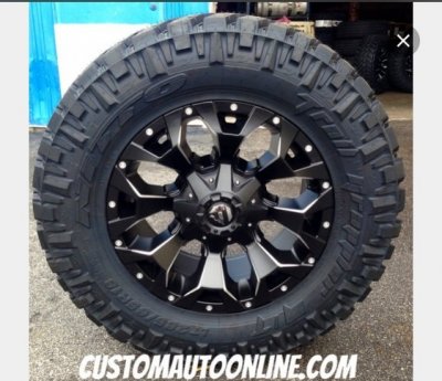

That's what I thought so I think what I'm going to do I already have a 2 1/2 inch leveler in the front I want fuel assault rims but I want to bigger stance because they don't come in anything but -12 so I was going to throw 1 inch spacers on

May want to wait to order the spacers. With -12 and 35s with just a level you may rub at full turn. I would put them on and see if you like it without the spacers first.
I had stock 20s and dropped to 17s and they clear the brakes fine.

So would the spacers hurt or help me with clearing when I turn?

-12 is more than enough for 12.50's ... There is no need for spacers ... Soacers will only create a rub problem id you are not fully lifted

Spacers will cause it to rub where?
