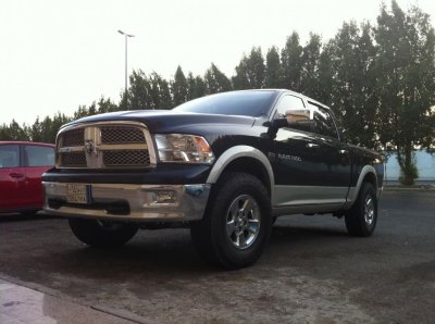

i got a ram 1500 2011 laramie and i have installed a 2.5 daystar lift kit. but now am thinking of getting a 4 inch lift kit .
am using my ram in lots of offroad trips rocks sand you name it , and i need more clearance 4 inch will be perfect 6 inch will be to much, as if i get a 6 inch am afraid that my 315/70/17 will look to small for my truck, or am i wrong about that ?
and i dont wanna buy new tiers ..
but the problem about rough contry that i saw some reviews that they are bad quality ? is that true?
and about the body lifts , will they do me any good in ground clearance as what i understand that the lower suspension will be the same and i will not get any clearance ?

I think it would still look ok - do it! Looks good now too man!

One thing a body lift does is allow more space for bigger tires which bigger tires will help with clearence, and will help with body clearence. So if you were gonna hit something with your bumper before, after you might not hit it.
Now with RC lifts i think they are fine on smaller/lighter trucks. If you do a lot of flexing, bouncing around id go with something more reliable. Pro Comps are real good lifts, expensive but good.
Just my 2cents. I did a lot of research when i wanted to lift my truck.

thank you all for the reply .
correct me please if am wrong
1. 6 inch lift will not look small for my 315/70/17 tiers
2. RC is a good lift kit but not the best.
tell now i didnt find anyone using them and gone offroading .. i wish i can get a clear overview.
if i could pay more than 2000$ i think i should take the mopar kit and keep my warnty.
these are some links i found they have most of the companys , the ZONE lift kit has a nice price also .
one more thing the shocks , there are hydro and nytro . what is better and why?
my wife is gonna kill me if i got the 6inch:killer:

1. Correct. Going to need at least 35" if you plant to do off roading. If it's a pavement pounder, 37".
2. Correct.
3. The Mopar kit is way over priced. There are several other companies that make lifts that cost a lot less. And, your dealership can't void your warranty just for putting a lift on. Check out SEMA action network. It's against the law to void a warranty for installing an aftermarket part.
4. Zone is the sister company to BDS. Myself and a few others run the Zone and are quite happy with them.
5. Here is a link to the shocks you were asking about.
http://zoneoffroad.com/catalog/catalog-shocks.pdf

i am running a 35s tiers or 34.5 . but they say that i should get me a 37 tiers if am going 6 inch lift :( and that will cost me more money i dont have . so i will stick with the 4 inch .and about the zone there parts are nice with a good price also , may think them throw.

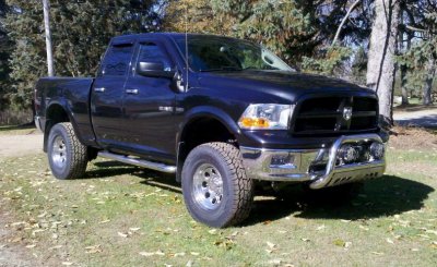

I run 315s in the winter. I have about 8" of lift (6" BDS + Bilstein 5100 @ 2.1"). This is roughly what your truck would look like...

See that looks good IMO .. I hate the stuffed look

Your 315s (almost 35s) will be fine with the 6" but youll have room for some bigger ones in the future.
