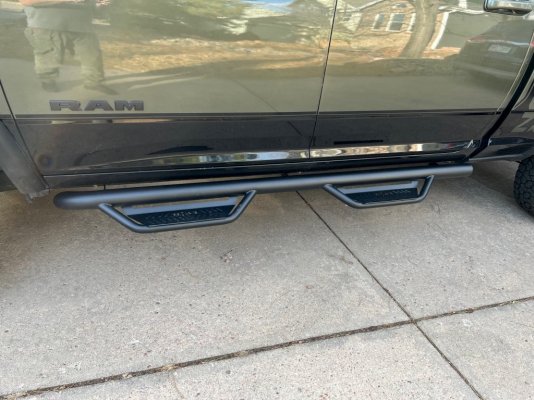

I have the NFab nerf Steps. I really like them but have not had them off road yet. Hopefully the clearance isn't too bad. Step1.jpg
