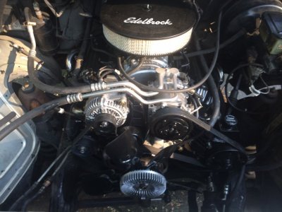

I know you said its routed correctly, but If you can, take a pic of your belt routing.

Took a couple pictures of the way MY belt is routed:

Mine is routed exactly the same. Looking from the front, my water pump is spinning counter clockwise. After thinking about it, that's how its gota be. The pump always spins the opposite direction of the threads on the clutch that way it's always "tightening" it.
