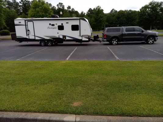

2019 Ram 5.7 4X4 3.92. Totally Stock. Properly set up WDH. Trailer as sitting is 7700 lbs at Cat Scale. You have something wrong. A picture is worth a thousand words sometimes. Totally level.Level Truck and Trailer.jpg

First off, the picture you posted, with the orientation of the truck and trailer on the grass/payment falsely amplifies the sag.
A properly adjust weight distribution hitch will transfer hitch weight to the front axle thus relieving the rear sag.
