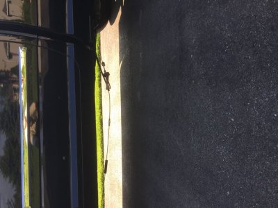

How do you upload pics?
F
Flhfxd
Oct 24, 2014
27
Hope this works

JJP71584
Feb 3, 2012
1,540
286
Pgh, PA
yeah my '12 looked exactly the same, tried to adjust it but it wouldn't move, dealer wanted $400 to fix it...no thanks. I zip tied it up under the truck so I can't see it. Still works fine

OK. You guys were right on the money......levers at the brake were not retracted. Persuaded them back into position with a hammer and the cable raised right up again. However, as I did initially try to adjust slack out of the cable at the mid-adjuster, and it is now at the end of it's threaded travel, I suspect that if I were to loosen it then tap those levers a bit more, the cable would probably tighten up properly. I believe the mid-adjuster is in fact a balancer for right / left brake as the cables split right there and are obviously of different length. The longer one being the hardest to "re-set" as you would expect. Geez, sorry that was wordy....but I think you can get it. Just a PITA issue.
