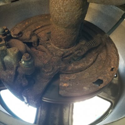

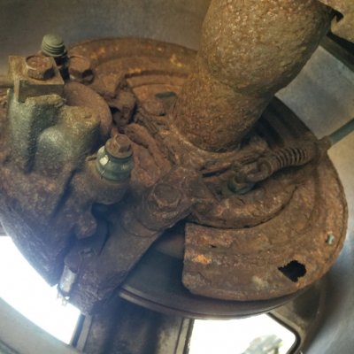

I started to disassemble the rear brake to take a better look, but the amount of rust stopped me. the Parking brake cable is sagging, and it maybe the Brake shoes are not retracting properly. S it time to replace some of this hardware? Or just clean and lube it?

Yeah, you got rust. I'd have to do a complete tear down removing the rotors. With that much rust your parking brake shoes may be needing replacement too.
That rust is severe!
Even the axle tube flange is beyond repair.I imaging the rest of the truck is a rust bucket!
I would replace the truck before throwing money at it.

Yes, that is what I am thinking. Both sides. Any brand recommended? Or stick with Mopar?
Personally I use Napa brake components but I have an account there and oem parts are not convenient to obtain. But alot of people recommend oem pads.
Beyond repair? Not quite. That really isn't that bad for the area he's in. A Harbor Frieight Needle Scaler would clean that right up. Seen alot worse in the north east. I would replace the backing plate too while I'm there. Pretty common for them to rust out on all trucks.
Funny you say that. Yesterday I went to a body shop to get a quote on replacing inner rocker panels due to rust, and his answer was ”You better sell this truck”. Sadly, I just bought it last year, only use it to launch my boat.
That's why I don't drive my 18 in the salty brine winter months. Sad what the chemicals do to vehicles.
