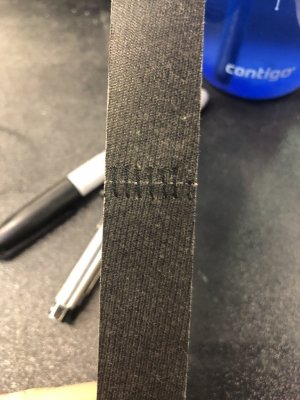

Serpentine belt seems to be showing an odd wavy pattern, as well as some unusual wear. Im no expert, but I don’t think a serpentine belt should look like that. Not to mention i have an intermittent squeak at idle

here are the pictures
Is this a normal wear pattern? I wouldnt think so

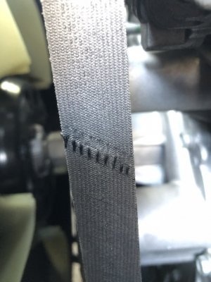

From the picture it looks pretty normal, but you are only showing 1 side of the belt.

I haven't seen the back side of a serpentine look like that. It seems the rubber on the back side is worn off exposing the cloth material underneath. The seam where the ends are joined is usually hidden by the rubber coating. I would check for binding on any accessory that has a pulley touching the back side of the belt. Looks like something is wearing the back side at an unusual rate. Also, check the belt tensioner to make sure it is up to snuff. Some of them have a pointer and scale. The manufacturer publishes a torque spec to move the pointer to a point on the scale.

Here is a picture of a brand new mopar belt for a 5.7. The seam is visible on a new belt. So I still don’t think anything looks wrong with that side of the belt that you’ve shown.

Hard to tell from the pic. if the other side doesn't have cracks in it you should be good. But when in doubt change it not worth breaking down
ok thanks, i wasnt sure if it was a seam or not because of how it was angled, looked funny to me. Ill keep an eye on it
