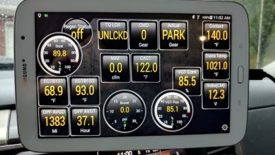

I really think its a regen, everything you describe leads to that except the every other day part. My truck regens about every 900 miles give or take. I do mostly rural country driving though. If you are in stop and go city driving and rarely towing it will regen more frequently. Every other day still seems excessive though.
Unfortunately there is no way to tell it's regening without an external monitor of some sort. I use a android tablet and an app called Torque Pro and have PIDs setup so I can see when it is regening and how long to the next one.
