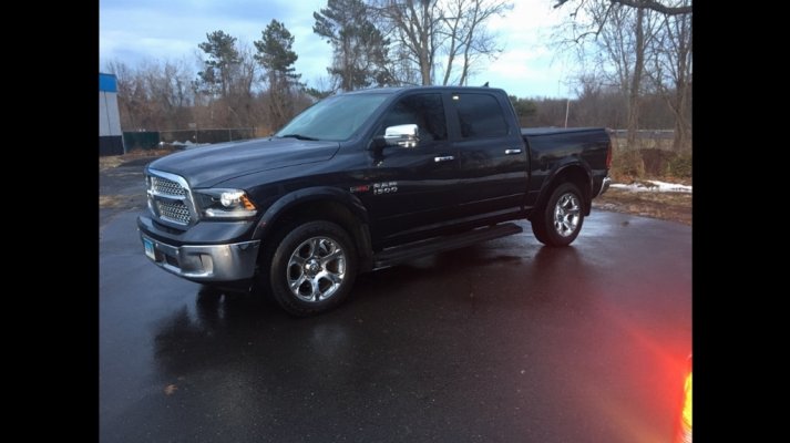

Can you post a pic of your truck after you got it back from shop #1?

This is literally at the shop right when I picked it up

Truck looks damn near leveled to me, indicating that there is probably no spacer or work done on the rear.
Assume you have a 2.5" factory rake (mine was about 2.75"), then put all that stuff in you should end up with about 1.5" rake. This truck at this angle does not appear to have any rake imo. Seems like you paid for something that may not have happened.

Good looking truck btw! But kinda hard to tell on the rake since its not a straight profile shot of the truck

There are no spacers in the back of that truck. They screwed you. The good news is that spacers and longer u bolts are cheap.

Coming from ready lift I'm sure they weren't cheap. Also these trucks don't have ubolts in the rear since they are coil sprung rear ends. Plus he probably paid for the labor to put them in
