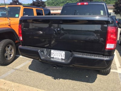

Finally made it down to Mufflex. Went with the 24" muffler based on a conversation with Denny, the owner. Loud under load, doesn't drone on the highway...I like it a lot. He made me a custom tailpipe that dumps at a level about even with the bumper and sprayed the last 12" of pipe flat black. Looks pretty slick and I'm happy with it.

Looks great and zero drone! This is what I am after.
Mufflex sells Magnaflow mufflers don't they? Is the 24" Magnaflow what they used?

looks awesome that is the direction im going i might get a nice chrome tip to just peak out a tiny bit
Yeah it was their 24” kit with a custom fabbed tailpipe. This way I can put the stock system back on when the truck goes.
Denny actually took me out in his 5-speed truck (2011?) that had the 18” setup with the factory dual exhaust. Didn’t drone at cruise but was a little louder than I wanted.
He said the single exhaust, all things equal, is a little louder than the dual. Also said because I’d be losing my factory resonator, the 24” would basically sound like his 18” kit or a little quieter and all of that sold me...and it’s true.
Keep in mind if the truck is under load (light to medium acceleration, towing, going uphill) it’s going to drone a little. But at cruising speeds with normal light throttle it’s whisper quiet. It’s actually perfect in my opinion. You could always add an inline resonator as well...or, if you don’t mind modifying your stock tailpipe, just cut it and/or add a different tip
