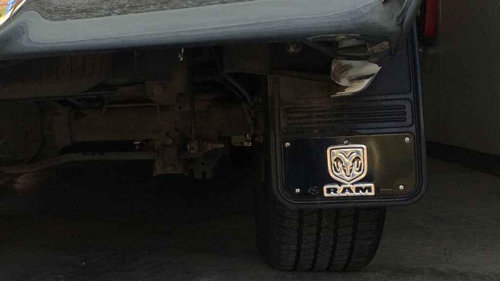

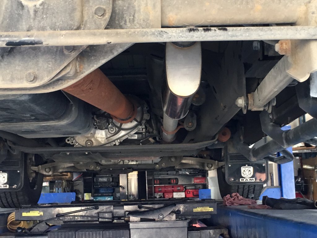

Here are some pics of my set up. The tailpipe looks pretty close to the spare in the second pic but it really isn't. In the third pic you can sort of make out the tailpipe in the shadows but it is pretty hidden from view.
