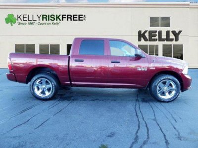

I had a Rough Country 4" lift installed on my 2018 Ram Express 4X4. It's the crew cab model. I now drift a bit to the left when out on the open highway. I have NOT had the front end aligned yet and I do see a slight disparity in height between the front and the back. The front is a bit higher than the rear. I don't drive the truck very often (it has 4000 miles on it) but want to be able to drive it safely and comfortably. Absolutely, positively get the front end lined up yes? Thanks in advance and thanks for adding me to the page. PS: Before and after18 Ram.jpg Ram Lift.jpg

Absolutely need an alignment. Even with a small level the alignment will be way off. A fresh alignment should have your truck steering straight again no prob.

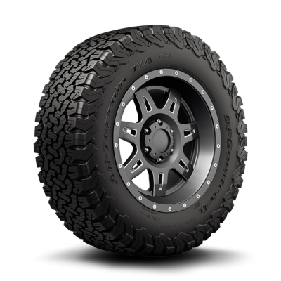

Nice looking pickup! Whatcha gonna do for tires and wheels?

Wheels? Ya know what? I haven't put a lot of thought into that aspect yet. Not even sure what size to look at OR if I'd be better off with an entire wheel/tire package. Probably going to need spacers and stuff like that right?
Any suggestions would ge greatly appreciated. Thanks again!!!

305/55/20 BFG KO2 For tires bud! Nice looking ride as well! Shouldn’t need spacers. Could run them if you wanted a little more stance or buy a negative offset rim to go with your tires.

I have to tell ya I love those Goodrich All-Terrain gummies.

After looking at your pics again, the rear looks like it is saggin’ ass. Almost looks like it lower in the back after the lift?!

That's exactly what I see when it's parked on a level plane. The rear seems to be lower and the front looks higher. Wheels.....I'm kind of mirroring that same thought.....I like the stock wheels. Maybe move up one size and into a slightly more aggressive tread pattern.
