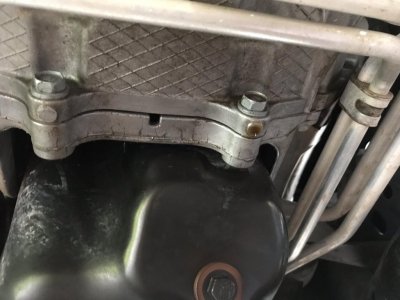

Small leak (?) bottom of transmission.

Noticed, what looks like a small leak on the bottom of transmission where it bolts to the engine. Never large enough to drip on the ground. Tried wiping it dry, but it would reappear after driving 10 miles or so. No matter whether it's raining or sunshine. Dries by itself after sitting overnight. Feels more like oily water.

Rear main starting to go maybe?

Engine oil pan gasket from rear end most likely. Where the rear main cover meets the block, it has a small dab of rtv and seeps through there if not properly applied. Not very common but we do get them once in a while at the dealer. Also sometimes its just oil residue from the assembly line.

Could also be front pump seal. The 8 speed fluid looks very similar to engine oil. It already has a dye in it. So if it glows with a black light it’s likely the front pump seal.

Good point. So, today the truck was left at the dealer for them to troubleshoot. Service advisor suspects bad rear main seal. We'll know more tomorrow.

Word from the dealer:
Pump seal in the tranny bell housing.

Just to give you boys and girls an update. Brought the truck from the dealership, no leaks found. Drove to the coast and back, no issues, no leaks. Two day later, looked under transmission again and sure enough, the dripping is there again, ugh....
Spoke with the dealership mechanic and he suggested to drive it for a couple of weeks, to purge/dry out possible residual liquid. If still there they may have to replace the transmission...it's 2019 classic with 11k miles on it. :emotions122:

Residual??? They pulled the tranny and replaced the seal and couldn't wipe the leaked fluid off??? Sound pretty shoddy to me.

I hear you...what the tech said, he couldn't reach under the torque converter, to give it a good clean, so maybe that's where the residual fluid is collected...
Interesting detail, the truck was parked on flat surface for two nights after the repair and no leaks. On the third day it was parked on our driveway (minor slope) overnight, that's when we noticed the drip again. Not sure, if that has anything to do with it or just the fact that it is a very slow leak and takes a while to collect.

That's bullcrap. To replace the front seal you have to remove the torque converter so here's the secret to doing right, when he removed the converter to replace the seal, he should wipe it then BEFORE he puts it back on... Just sayin' :rolleyes:
