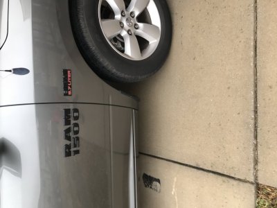

Got my side emblems on today they look much better now.

Any tips or tricks as to how you swapped your black "RAM 1500" emblems as far as getting them back in the same position???

I outlined them with duct tape and then gently pried them off. Then use the tape outline to install the black ones. Works great.

Can you post the pics upright? It's hard to see that way!!
Looks good though!

Painters tape works great as well and won't leave any glue when you peel it. If you heat the emblems up with a hair dryer it will soften the glue holding them on and then take a piece of fishing line and run it behind the emblems up and down. They will literally fall off the truck. Wipe away any residual glue with some good off cleaner and apply the new ones .
