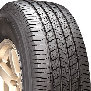

Hello, I am looking for some advice on snow chains for my 2015 Ram 1500 LoneStar 4x4. I’ve read through a bunch of forums and it seems most of the forums suggest you can’t put chains on without there being a clearance issue. I am planning on going to South Lake Tahoe and I am concerned about having traction issues. I can’t really afford to buy snow tires right now. I have pathfinder HT 115T 275/60R20 tires. As well I can’t find anything in the manual about this issue. If I can’t put snow chains do you have any other recommendations of what I can do?

Pathfiner HT is not a very aggressive tire so it won't bite great in deep snow, but should work fine on ice.

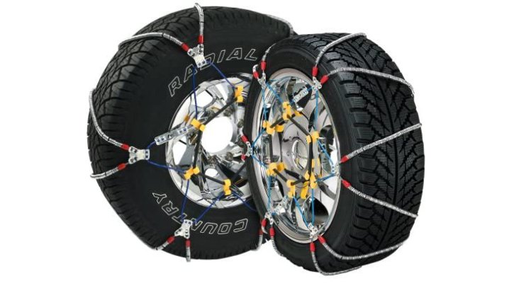

If you still want chains, get cable chains, clearance should not be and issue and they are easier to put on. Amazon sells them, if you don't end up needing them and won't in the future, they can always go back.
Security Chain Company SZ143
Specs​
  • Type Cable
  • Tension Adjuster Yes
  • Weight 1 lb.
Pros​
  • Versatile design works with virtually all vehicle types
  • Very low profile on the tires
  • Relatively easy to install
Cons​
  • On the more expensive side
  • Installation can be finicky with small components in cold weather
  • Chains can slip off if not installed properly
Derek Mau
Security Chain Company has been in the tire chain business for a while and has worked tirelessly to perfect its art. The SZ143 Cable Tire Chain ($124) is the product of years of tinkering and seeking perfection in manufacturing. As such, they’re some of the best cable tire chains on the market.
The SZ143 Cable Tire Chains boast a utilitarian design and can be used on passenger cars, SUVs, and trucks alike. The low profile of these chains allows them to sit comfortably in virtually all wheel wells. So, clearance between the tire and the car body is rarely ever a problem.
Of course, the primary reason to buy chains for your car is traction, and the SZ143 from Security Chain Company provides some of the best traction available for cable-style chains. The all-embracing cable system is an improvement over traditional styles and provides traction across your entire tire. Plus, the rubber tightening device ensures that they’ll fit snugly and not fall off while driving.
For many people, one of the most intimidating things about buying snow chains is installation. The SZ143 has addressed this, and many users have noted its relatively easy installation design. If you’re looking for a cable chain system that provides ample traction, is relatively easy to install, and can work on most vehicle types, then look no further than the Security Chain Company SZ143.
