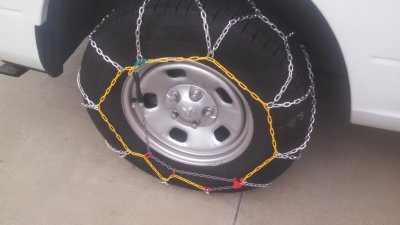

I had the same form in my paperwork. Mine is 2WD with P265/70R/17 and the rear brake line is very close to the tire. If I used real chains, good chance that the brake line would be taken out. I've also read, at least on the newer Rams, you can only put chains or cables on the rear of 4WD. Something about clearance with suspension on the front. I tried on a set of Z chains, like were posted earlier in this thread, and the inner hardware and cable were almost touching the brake line. I was afraid to even drive it.
Then I found these other "Titan" chains sold by "etrailer" which have one stiff cable on the inside,and the rest is smaller chain, and they seem to have plenty of inner clearance, so I'm carrying these. However, with larger tires on the 4WD, maybe regular chains are fine?
BTW these are very easy to install and come in a nice, compact case. That said, I'd rather use real chains, but in reality I use them very infrequently, and usually only for a few miles on winter trips to the local mountains.

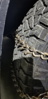

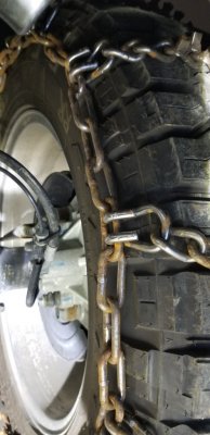

These are my tire chains on my truck. You can see they are about the most aggressive chains out there. Square studded can-v. In the picture you see there is plenty of brake line clearance.15461348831412638098880598312980.jpg 15461349301177669558809281818659.jpg

I got that, just wasn't sure why it was directed at me. I just suggested getting chains with cams so they're easier to adjust and keep tight.
