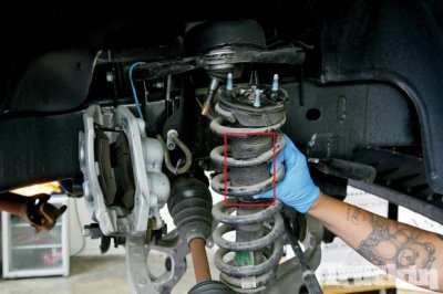

So last night my brother, his friend and I installed the 5100's into my truck. Everything went fairly straight forward except for two issues. First is I had to cut the shocks out with a sawzall :superhack: because we couldn't get the top nuts loosened to get the shock cap off. When I reinstalled it; everything went back in and I reused the applicable hardware and reused the (partially cut) rubber boot that fits over the top (between the cap and the coil, the part contained within the red square in the attached pic). Now whenever I hit certain bumps it sounds like a clunk as though something is loose. I brought the truck to a mechanic to have them do the alignment and asked them to take a look at everything to make sure it looked good and they advised it was...so now I'm wondering if the partially cut boots are whats causing the noise. When I compared the assembly to the the Rancho Quick Lift replacements they don't have anything in there as far as I can see; do I even need them or can I cut them out?
Attached are obligatory photos lol
