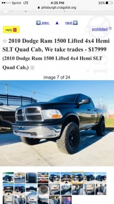

I know the bumpers changed in 13. But are any of the guts the same on a 10? Like would a 13 bumper cover go on a 2010 sport?

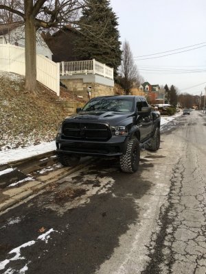

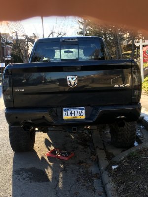

I replaced my 2010 chrome bumper with a 2016 painted black bumper from ebay. I think it was $276 shipped. Cant beat it for the price. I still havent installed the front bumper absorber. Cant figure out how to get it to mount. Im hoping the 2010 front end isnt different than the 2016. I was able to get the bumper to stay on with just the center support, and bolting the sides to the fenders. When i get around to it im gonna take the bumper back off, and see if i have to take something off that i didnt see in order to get them to go on.

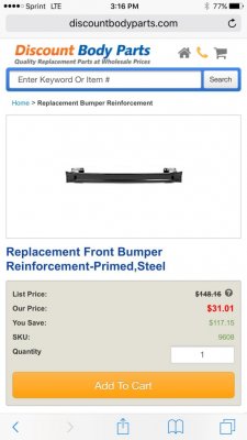

I also bought the metal impact bar, but it wont bolt up either. I paid $31 aftermarket. new from dodge they are $287.
I also bought a dual exhaust rear bumper off of ebay, and had it painted for $250, and bought a used painted 2016 grill for $200 on ebay.
Here is the metal impact bar i bought that wont bolt up. Bolt holes look like they need to be 1-2" longer on both sides to bolt it to the frame. If anyone sees something missing from it, let me know. Im stumped.
