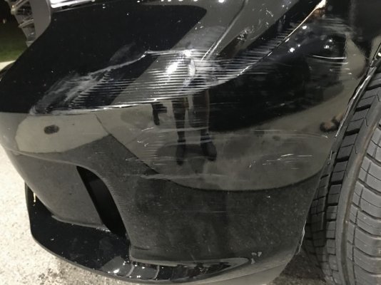

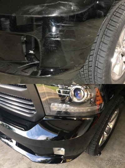

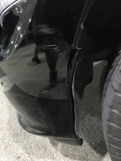

Havent been on the site for a while, but few months ago(6 months after i did the swap to the sport bumper) it got wrecked... Following my friend in his corvette late at night, he hit a semi tire tread in the middle of the road, and kicked it up at my truck.
took out the bumper, fog light, reinforcement, and inner fender well. I had them all replaced with oem parts(i had bought my bumper cover off of ebay) for a total of $1400 including labor.
