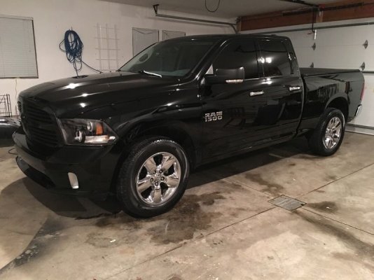

I got my bumpers swapped out this weekend, overall it wasn’t too difficult. The worst part was putting the air dam on, it took forever to get all the clips in simultaneously. The damn things kept popping out on me as I worked my way around. I’m thinking it may have been a lot easier if I had installed it before attaching the bumper cover to the truck though. Also, I still ended up with a few parts that I didn’t need. So for future reference, these are the only parts I ended up needing for the swap that I couldn’t reuse from the old bumper……
68197698AA BUMPER COVER W/O PARK SENS or 68239435AA BUMPER COVER W/PARK SENS.
68003844AA AIR DAM PUSH PINS
68196999AB IMPACT BAR
68145441AC ENERGY ABSORBER
68033135AA AIR DEFLECTOR
Thanks again OP for the write up, it was a HUGE help!
Before....
After....

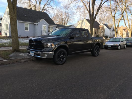

Has anyone done this conversion with stock fender flares?
I am going to do this next week (now that I have all the parts) and I have stock flares that I think might be tricky to work with.
Any help would be awesome.

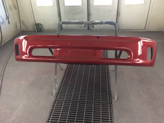

I priced it out and it was at minimum around $900 to $1,000 with paint. I'm probably gonna go the route you went with and get a paint-to-match steel bumper and have it color matched and do the same with the rear bumper. All in, it should be less than $700 for both.
