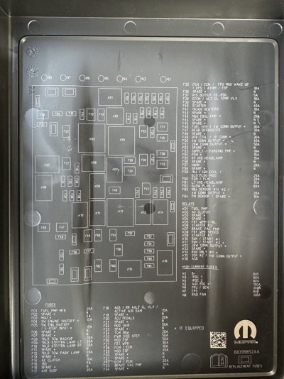

On MY 19, shows (2) relays as starter relays, K06 and K09. Also F40 as Mcase 40 AMP. OP has a 2020, should be the same as my 19.

I'm not familiar with the 5th gens fusebox or relays,but i'm guessing one of them is the actual starter relay,lol
YUP, just not know why they list 2, lol.
@Wild one.

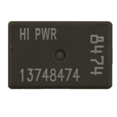

See attached, here is my fuse box and info from Distro Case Top. I have both the starter 01 and starter 02 relays and 40 amp fuse. IF I was OP, I would buy both relays and replace. They are not that expensive. He also needs to check the 40 AMP case fuse. But if that not work, needs to go to a good mechanic. My thought is: if a relay went bad and was supplying constant power to starter, may have fried the starter too. But unable to diagnose on Internet Guessnosis. Now my truck is a 2019, No E Torque. IF OP has E Torque, he may have some more fuses and whateva may be associated with the E Torque and/or stop-stop if OP has that also.

If you are getting a hum, heat in there, then it's likely the replay points are stuck / welded together from too much current draw as a rule. you could check with a ohm meter, if you knew which pins where the contacts. they are easy to check with jumper wires and a battery.
easy way is just stick in other ones a try it , if nothing happens, then put a volt metre on the main starter post, and if it has 12V when trying to start, them pull the starter and check/ replace. If the points are welded, you will have 12v on the starter when you are not trying to start the truck.
Pull those 2 cck brakers, 6 and9 with the battery hooked up and you will be able to tell is they are shorted or not by the sound., plus it will be hot.
