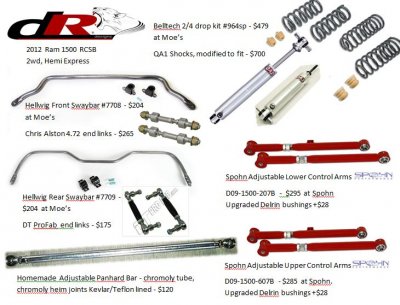

For me the decisive point was the McGaughys and how they pushed the front wheels out a bit... I could see it immediately on other Rams and I knew I could never live with that. The other issue I absolutely cannot live with, is the rear axle being off-center (pulled forward) after lowering... Just my .02.
I would just get the BT kit without shocks, and run it with the factory shocks. It's a great and cheap start that you can build on as you discover weaknesses or needs (or wants).
You've probably seen my list already... this is where I finally ended up with my suspension.

The Mcgaughys kit I'm going for is coil spring front and rear just like Belltech I'm not using there lowering spindle and at summit Mcgaughys is exactly $100 more I have reasons that I won't use Belltech from past and present I'm not going to bash them there products just aren't for me. And Davidram no matter what kit you use with the coil rear suspension the rear end is not going to be dead nuts center unless you use the spohn upper and lower control arms and pan hard bar which I will be using I'm just going to start with pan hard bar first get some other things first then come back to the spohn arms. Please correct me if I'm wrong

Of course the axle will be pulled forward with either (any) lowering kit... The point was to consider that and plan your parts list accordingly, IF that is something that would bother you.
