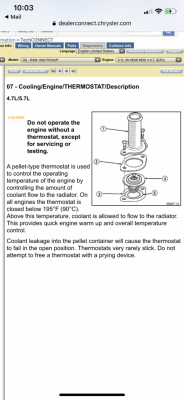

Stock thermostat

The stock unit that came out of my '16 5.7 was a 203 as was the stock unit in my '17 392(Challenger). Only the older trucks came with a 195, but I can't remember when they made the switch to 203.

Wow. 3 answers and only one of them bothered to look at the actual thermostat. Lol
I honestly haven’t had a thermostat out of probably a newer truck than 14. So if you guys are pulling out 203 ones than they need to update their service/parts info. Shows 195 right up to 2018.
Replaced Factory 203 in my 17 w 170

Watched mine today and ran a pretty consistent 197F.
If you've never changed your stock T-stat,you didn't drive it far enough Dan,lol. The stock T-stats are 203F,and nobodies trucks run at 197F with the stock T-stat,unless it's still warming up. Both the cars and trucks use the same 203 T-stats in the 5.7's,the only 4th Gen gas powered trucks that use a 195 T-stat were the old 4.7's and they discontinued the 4.7 in the trucks in 2013.
