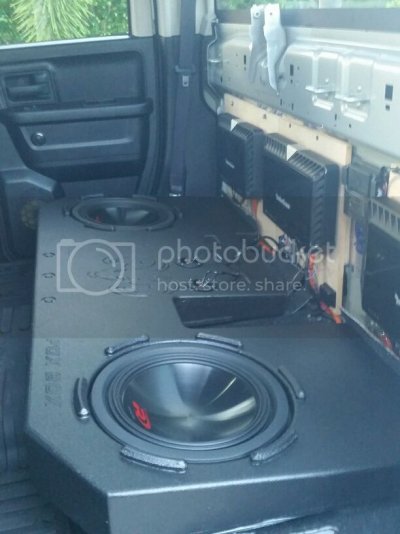

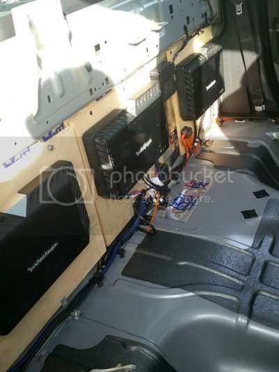

I have some Rockford amps in my 16 ram here is a pic of my install as I was working on it. Fox box with 2 12s and 3 Rockford amps
Is that enough airspace or those subs? i always thought foxboxes were under 1cubic foot per sub?
like stated above if you dont want a new box you wll have to get subs that are recommended for the space you have. like the slim subs.
