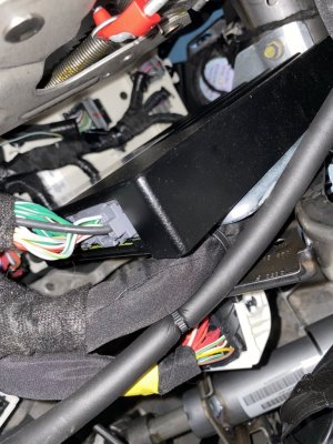

Ok. I need to know if you have factory amplifier under the dash board driver side or if you have a module that look like a factory amplifier under the driver seat.

Ok. If is not under the driver seat check for a factory amplifier left of the steering wheel column under the dash driver side. If is there you need to cut 4 wires. Check if front doors is just bass or full range.

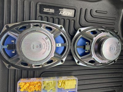

Just an update on this,
2019 power wagon with alpine system
I installed this today, took around 4 hrs.
2 sets of Kenwood KFC-6986PS (4 speakers) front and rear doors
JBL Club 322F dash speakers
T-Spec V10-AK4 Wire for amp and subwoofers
AudioControl LC2i (Black)
Metra HWP-0001
Metra 72-7902 Speaker Wiring Adapter
Metra 72-6515 Speaker Wiring Adapter
Here are some photos below on how everything looked and some examples on how to Splice into your stock speakers for the LC2i easily.

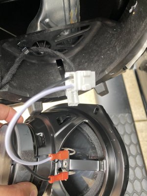

If you pop your center panel off you can unplug your harness to your back door speakers and splice into them here.
4DF1F0B2-09C8-46D3-90FB-54E6AA927709.jpeg ADD28FF3-9802-40CE-A19A-8B1B065E8726.jpeg
The door speakers were really deep but they fit well and I didn’t not have to modify the screws to make them fit.

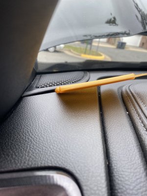

75C5BBA4-96A1-49E4-8EA5-1B5E7EAF2C47.jpegThe front dash speakers cover snaps in and out of place. Here is an example on how to do it without scratching.

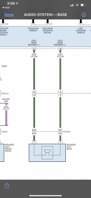

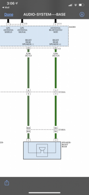

78A52495-8D6D-4C04-93A5-B6745AE51501.png C7013A03-FF1B-4077-9E08-BADDCD6DB3CE.png 020E7C31-6F5F-4AE6-B21E-503A3CFDB09F.png
here are the diagrams for the rear speakers if you need it to add a subwoofer.

Did you splice right off the merta speaker adapter.? That would make sense. You do both sides or just one?
I spliced both sides at the center door panel, I did not splice off the merta because there was no way to run the wires back through the door into the truck without some drilling and mods which I wasn’t going to cut up a new truck. Once I found the diagram online, I found it was easier to locate the colors inside the panel between the doors.
