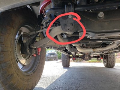

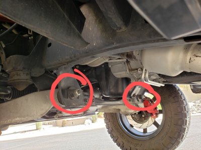

The LCA's adjust the alignment on the RWD trucks. If you crawl under there the caster/camber bolts are where the diff should be sitting.
If the 4x4's are the same then you should be gtg.
