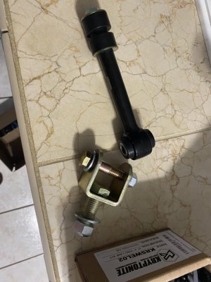

Sway bar links came in. The bolt in the u bracket is a 1/2” so I think it’s to big. I emailed kryptonite seeing if they can offer a set for the ram possibly in an 8” for leveled trucks. I may go ahead and remove the bolt and tack weld in one that will fit our lower control arms for the time being.

How close is it to the hole in the lower control arm?

Obviously not dropping it to 1/4” but this is where my brain went to unless it will make it too long

I think that would be to long. I’m going to just cut the tack welds and swap the bolt out. It’s super easy to do anyways.

Good news and bad news. Spoke directly to someone at kryptonite. They will be offering links for ram 1500 in the future. However, they will not be offering them with the “clevis” style bracket. They will have a ball joint setup. Their Ford links are the updated version that the ram ones will be released as. It’ll basically just be a heavier duty version of the stock link. I’ll proceed forward with modifying the one I have. They said they can make something for our trucks that is 8” for the leveled trucks if anyone is interested but as mentioned it will just be a beefier version of the stock links.

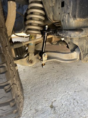

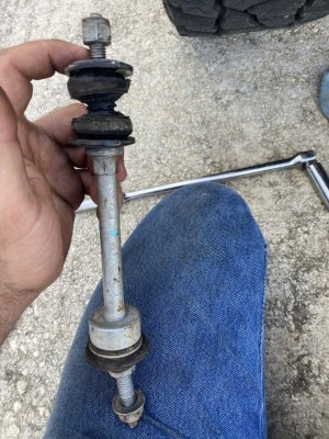

Changed the lower bolt out to a 1/2”. Factory was 12mm and I could not find any 12mm at my local Home Depot or Lowe’s. My idea for using the bolt through the lower bushing as my disconnect went out the window. In order to spin the sway bar up and out of the way the end link hits the tie rod. However, the top bolt through the sway bar is super easy to get to and remove and will probably end up being what I remove to disconnect the sway bar. If for anything I have beefier end links. My stock ones are looking tired and abused. More or less i wouldn’t do it again like this. These trucks are a pain in the butt. I need to just buy a Jeep. Lol
